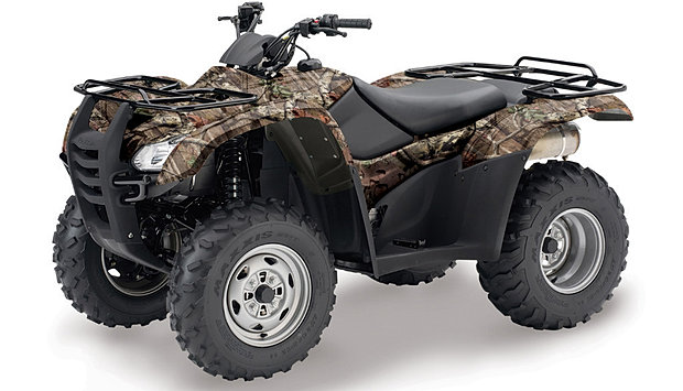

I haven't fitted the new rear shock absorber yet. I got some of that camo vinyl wrap to cover up the pink paint on the plastic fender flares.

OH, I tried using that vinyl cammo wrap. It didn't work out that well. It doesn't work too well on curves. Maybe flat surfaces. The guys on YouTube make it look too easy!
Apparently the release again the company used when they pull the bodies out of the mold, if not removed, causes the paint to not adhere the plastic very well.
So I'm going to scuff up the body with a Scotch-Brite pad and use some sand-able primer and Rustoleum white gloss.
