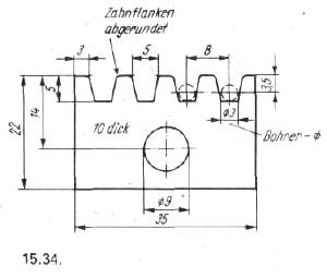

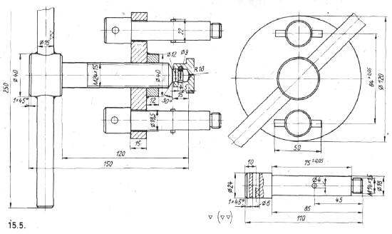

You will need to bolt something sturdy to the flywheel to prevent it from turning as you loosen this nut.
or something similar.In use:
or with another tool:
If you want to build your own flywheel-puller:
