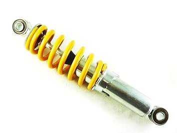

Just the front bumper to fix back on after repainting it, and bleed the rear brakes, and fit a new lower bush on one of the front shock absorbers, and then Hildegard is ready for the MoT test. All four front bumper retaining bolts sheared off when I removed it. Why oh why use piddling little M6 bolts for that application. So I have had to drill 4 new holes and tap them out for new bolts. Has anyone come across a suitable substitute shock absorber easily obtainable in the UK instead of sourcing one from Germany?

Just use Imperial fasteners like I do if the hole is not tapped out for a bolt! Then use a metric wrench that comes close.
Imperial bolts are like 5 cents a piece over here but a 13 mm bolt the same length would cost $2.00. Not that they are anymore imported than imperial. No wonder Americans hate the metric system. Having to pay more for a fastener just because it's metric.
I found lots of things secured with a bolt and a nut instead of the part being drilled and tapped. Seat belt anchors, external voltage regulator, etc.
I guess by doing so increased the labor it took to build these cars. You know, Central planning. Create jobs for people instead of giving them a welfare check.
TN Trabi said he used some shocks from a Chevrolet but that's probably of no help since Chevrolets in the UK are like Trabbis in the US.
We have quite a few Chevvy dealers in the UK, and they acquired the now defunct Daewoo brand who made the Matiz[ATTACH=full]4909[/ATTACH]
A nice little runabout, and maybe the shocks on this model would fit. They also sold some other small cars, whose names escape me, so I'll have to make some enquiries. Cheers turbofiat.

if you take one of your old ones to the motor factors they may be able to match it up,they look a bit like old bmc mini ones but you need to put them side by side to be sure,shocks come in different lengths as well as with different fixinngs,ive just swopped some on a jag and they are the same fixings as a trabi but longer
I'm surprised Chevrolet entered the UK market. I saw some US spec Chevrolets while in the UK but that was back in 1997-2000.
I figured since GM already had the Vauxhall and Opel brands there wouldn't be a need to sell Chevrolets in the Europe.

Wonder if you can use shorter coil over shocks and it will lower the car without much fuss. I don't know what effect using coil over shocks in conjunction with leaf springs you have.
We call them McPherson struts here. I don't know offhand any that would fit. They would have to be pretty short, and anyway I would have to get a pair and it's also straying from originality. Any aftermarket alterations I embark on I don't want to be too obvious.|
